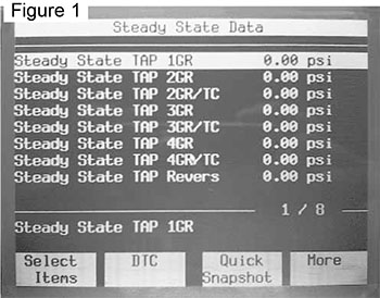

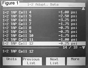

Did you reset the TAP as I have pointed out more than once
An instant quick shift sometimes also means gm torque abuse sometimes has to come into play(reducing power) but ultimately its harsh people want smooth, crisp, and harsh things dont do that. Although that means no excuse for non luxury uses for the 3.8 and 4t65e
Yes, I disconnected the negative battery terminal for at least 24 hours.

and the tap. the repair worked well because with the new springs which put up a mound of dirt, and the TAP reset was like putting a retaining wall for that dirt. Odd example, but that was the first idea how to explain it. The old pressure adapts wouldnt have worked at all for your repair since it would still be trying to shift like nothing changed(Fluid, SPrings, etc)
Funny that I didn’t reset my TAP and it worked fine. Weak accumulator springs are the reason the shifts get slow and subsequently the computer compensates by increasing line pressure to max. Easy.
