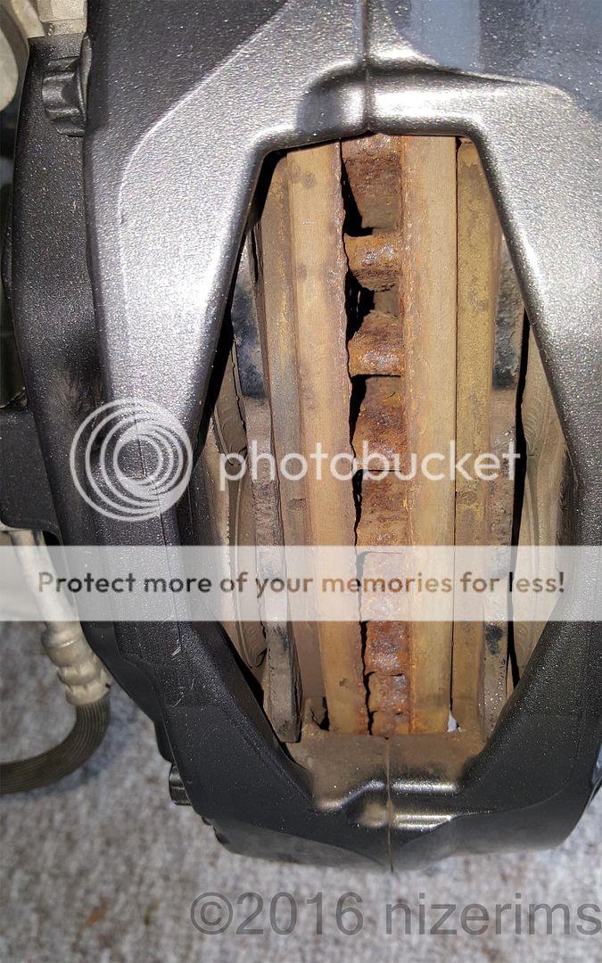

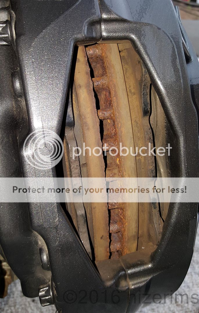

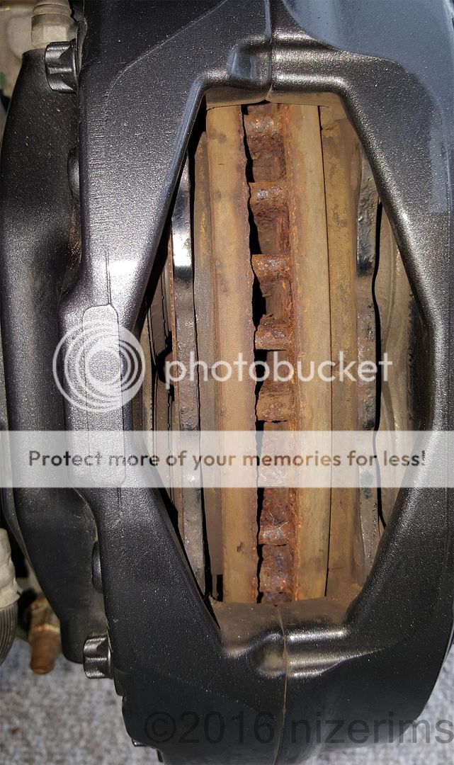

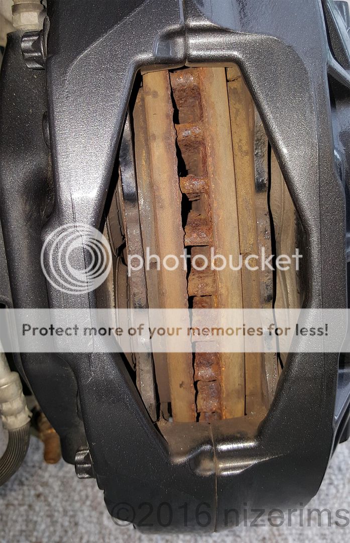

To the best of my knowledge the design of the GS BREMBO calipers changed for the 2014 model. The first time I had the front wheels off, I was in the wheel well cleaning and something caught my eye..... I didn't say anything on the forum because I wasn't positive that my suspicions were correct.
As You guys know; on the 2012 and 2013 GS you can punch out the caliper pins, remove the brake pad spring, and wiggle the brake pads out without having to remove the caliper...... It just didn't look like this was going to be possible on my 2014.

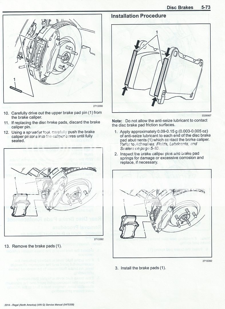

A few months went by and thought about it again while flipping through the 2014 service manual. The pictures in the brake section of the service manual show the (older design) calipers I had on my 2012; and for Front Disk Pad Replacement the service manual says "remove the caliper pins, remove the brake pad spring, fully seat the caliper pistons into the caliper bores and the pads will slide out".
The next time I had a wheel off I went through those steps to see if I could remove the brake pads....... "NO GO"....... I used a brake spoon to push the pads away from the rotor and slide the caliper pistons to get them as close to home bore as I could get; without removing the caliper..... I went real easy on them because I refuse to put any serious angular pressure on the pistons...... I went as far as removing the rotor bolt (the bolt that holds the rotor to the hub) to see if I could wiggle the rotor, and maybe that would allow me enough room to remove a brake pad... NOPE!
SO, as of MAY 27'th 2016, I'm going on record saying that you can't remove the front brake pads in a 2014+ Regal GS with the updated BREMBO calipers, without removing the rotors................................. (I tried,,I couldn't do it)
*****If someone proves my finding erroneous and posts pictures showing the tools you used and how you did it.... I will buy you a pizza!*****

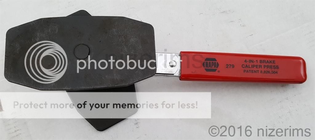

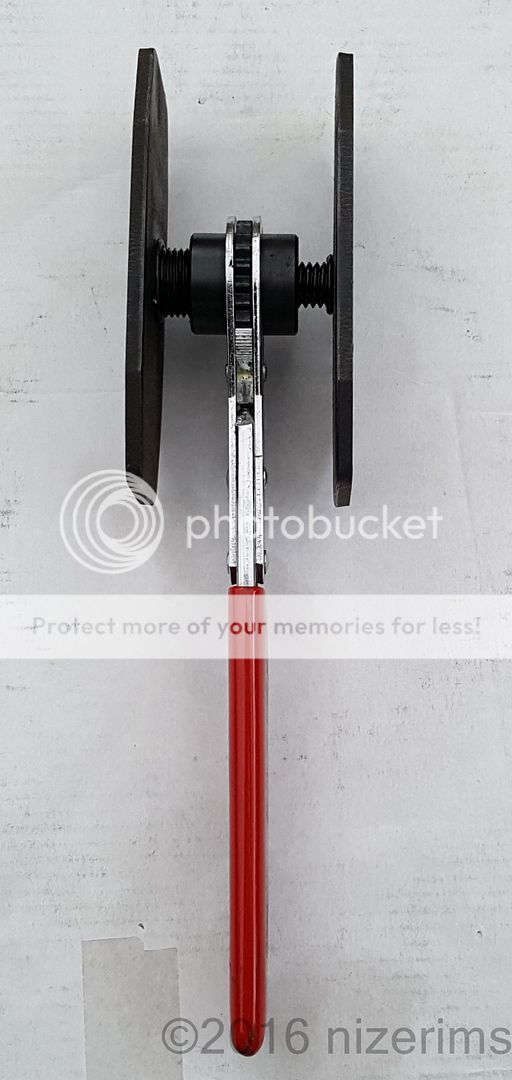

In the past I've used brake spoons and the 'ole screwdriver between the pad and rotor gimmick, but how are you guys carefully seating the pistons into their bore? (without gouging the pad or rotor).....Do you have a tool I don't know about?
I have this 4 piston caliper tool, and a few different brake spoons.

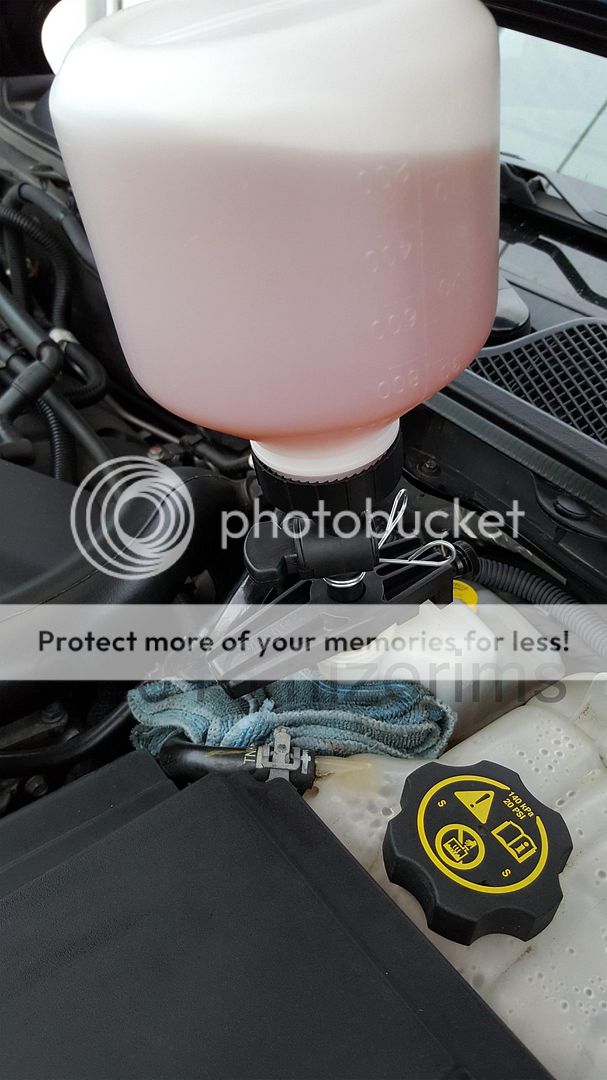

Hook me up with some tool info and I'll show you my new favorite.....
.......cool tool, so you don't run low on brake fluid while bleeding. Mityvac MVA6832

Good catch Walt. Thanks. That is a typo...... I tried a few different things to remove the pads without removing the caliper. Nothing worked. I had to remove the caliper.
The only way I can imagine someone is getting the pads out without removing the caliper is:
The front rotors would have to be turned/resurfaced a few times. &
The brake pads would have to be broken or completely worn down. &
Some type of pry tool would need to be used; jeopardizing the painted finish on the caliper.
