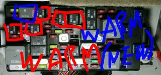

As promised in my previous post, I removed the fuel pump relay that came in my brand new box from GM. I replaced it with the new low profile relay. The relay and some of the other tall black relays surrounding it got warm but did not get as hot as the normal sized original relay that came in the new box from GM. I guess we'll keep some spare relays in the car and drive it and see what happens. That GM refuses to address this is unacceptable.

I Just replaced my fuse box on my 2011 lucerne. I noticed my fuse relay still gets warm but not as hot as before, is this normal?

I know this is an old thread, but yes. I just replaced the fuse box in well under an hour. Just disconnect the battery, as always when doing electrical work. Then, take a couple medium flat blade screwdrivers and pry the retaining clips on both the front and back of the fuse box while pulling up. It comes out easily.
Take a picture of the plus and block location on the back of the box with a smartphone for reference, just in case.
There are 2 plus, that require a small flat screw driver to release the tabs, and then 3 wire blocks that are attached with a small cap screw in the center of each block. Remove the screw, take a the same small flat screwdriver and push down in the slots on the side of the plus to release the alignment tab while pulling up on the block.
Check the blocks to make sure there are no burned wired or connectors (unlikely) and install in same position on new box. Hand tighten the screws with a nut driver. They just need to seat all the way down. No need to over-torque the screws. Now snap the box back into place.
If your box came pre-loaded with fuses and relays, you're done. If not, move all of the fuses and relays out of the old box and install them in the same position. You'll need a new relay for the fuel pump if that was the problem.
Now reinstall the cover and connect the battery.
Start your car, and have a beer. You're done.
I did all this today it was easy. My relay fuse still.seems a bit warm not like before but warm. Is this normal or what
