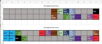

There was an error in my original pinout, the check engine control needs to be on pin 16.
Updated the diagram. Will continue to update as I work out the bugs.
