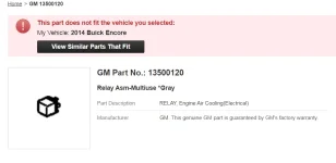

I've had the issue as well, but the source of my issue was was Relay 6 going bad after installing a new battery( I guess it would still read on). I'd suggest wiggling it or removing it to see of the fan stops. If it does then it's the Relay(This shouldn't be a thing)
