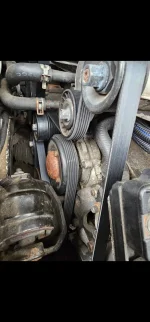

Can you show me closer on the belt like directly top down and also the ribs up close.

can you find the tensioner adjustment marks on both tensioners, but first start with the one for the supercharger belt.
What exactly am I looking for? I assumed they were self tensioning and did not look for any marks when I installed the belts. I'll address the battery tomorrow. I have an oreillys up the road. The video would be too large to upload but I can Rev it all the way out in neutral and park with seemingly no issues. I drove it again and it does have a rough idle and misfire below 2k.
Did you touch the ignition wires or the spark plugs in any of your work on it? to me it sounds ignition possibly. Can you tell me how it goes about stopping to rev past 3k, does it chop, shake, flash the engine light, etc.
The tension marks should be on the round part of the tensioner (lower one) i sent you a diagram above in my previous messages but i screenshotted the part that shows where it is here in this message
They are self tensioning, but they only work in a short range of belt sizes, and if they are on the "stops" they wont do their job.

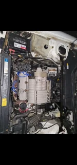

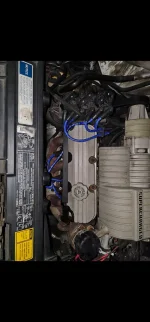

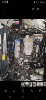

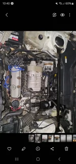

what firing order did you put the wires on? And can you show me a picture of the plugs you removed and the current layout of your wires/plugs (so a picture of your engine bay basically)
I put them on exactly as they came off. The ones I bought were labeled. I threw the spark plugs away. But i can get you a picture in the morning!

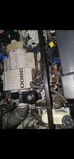

Can you remove the engine cover
Your wires are incorrectly routed, #1 (the lowest on the coils) should exit where your #5 exits, the #3 exits where #5 should and #1 takes way too long of a trip to get where it goes
What brand are these wires? If they are what brand they appear to be, ive had them be bad in the box and they are fragile as far as wires go. A;sp. tje wires cross the paths of other wires too frequently and enough to create a misfire condition by inducing spark on the other wire.
Also I hate to ask, but what happened to your engine oil dipstick and what is shoved into the dipstick opening in place of it
also whats the wiring splices by your EGR all about?
Also I cant be sure of it from the photos but you appear to have cylinder 6 and 2 wires swapped on the back of the engine. but i cant see what the wires do where they travel under the snout/engine cover. so re-laying the wires to be alongside eachother on the wire holders from front to back is a helpful thing to do to ensure they are
The wires are NGK they all came labeled. I did them one by one but I will double check to verify. I didn't take the snout off when I did the wires so I just pushed them through the best that I could. I didn't know that crossing them would mess it up that bad. I can go through and redo those. The dipstick handle was glued together when I bought it. It snapped today when I bumped it. I have another in the mail. The egr wires got chewed before I bought it. I drove it 6 hours home from Tennessee like that and it was smooth as butter. I also replaced the pcv valve trying to chase this issue, but no improvement. It's always had a little miss at idle, but everything I've done to tune it up and clean up the oil leaks made it worse.
