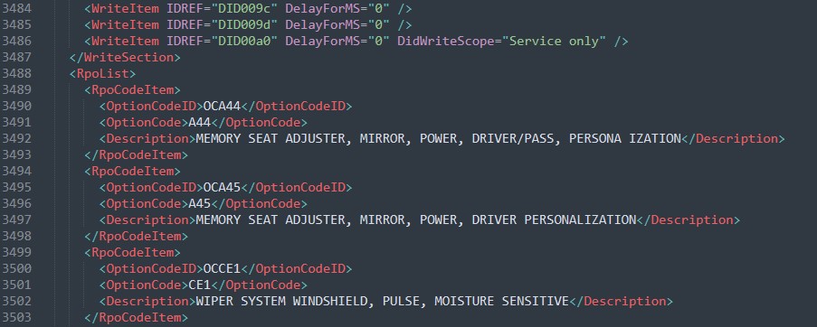

Sorry to double post, but I think flashing the build data with RPO A44 will rectify the passenger memory seat issue and possibly the ventilated seats. The only difference I can find in the build data between the GS and TourX is this single RPO which, weirdly, specifies if the car has 1 memory seat or 2. I don't have the seats installed but if anyone does, I'd be happy with the process to see if this gets it going.

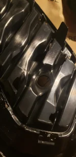

Is there an extra part on the GS that the parking sensors clip into? I have the OEM and aftermarket covers and both of them seem like there is a piece that clips in that would hold the parking sensors but i'm having trouble finding them on any parts website. 20251215_215417.webp

Normally there would be a plastic bracket that's factory plastic welded on there if it's OEM. You can use plugs to fill the hole. I got mine from AliExpress which did not have the hole.
