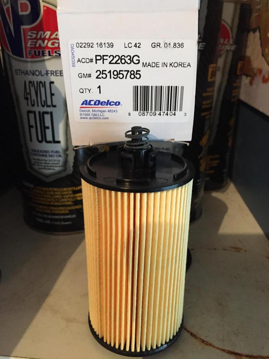

The valve bypasses the filter, so the engine does not starve for oil, if it is clogged by not changing the oil when it should be. I noticed the Heinst filter will distort when forced into a UFI housing but not sure if it seals well at the ends. I think the damage from using the wrong filter would happen if it was not changed before the filter started to clog. Maybe oil testing would tell you something but I don’t have any experience with that. Maybe others can chime in here.
So looking at the parts manual at GMPartsDirect there was only one oil filter listed for my 2018 Encore Premium Trim. Since I have always done my own oil changes, I ordered six of the AC PF2257G oil filters. Unfortunately when I went to change the oil, in spite of what the parts manual said for the "premium" trim, the engine had the AC PF2263G oil filter. That meant an unexpected trip to the dealer paying full retail price for the other oil filter. And, if anyone wants some of the PF2257G filters for the Hengst housing I have six brand-new ones that I can't use -- lets talk.
Here is a comparison of the two oil filter designs that are used from 2013 to 2019 on the Encore, and it occurs to me that someone in a hurry could easily put the wrong oil filter in -- as the two are very close, but the one on the right (UFI) has a built-in bypass valve! Installing the PF2257G into the UFI housing can cause serious engine damage! It might be advisable to at least show or print a tech note (link) about this and take it with you. There have been many reports of the wrong filter being installed in Chevrolet Trax, Sonics and Cruzes with the UFI housing.

I'm not sure even if the VIN lookup works. I just looked under the hood and saw I had the Brown Cap vs the Black one. so I needed the UFI filter which has the Spring on it PF2263g

What is scary, is that the closest Chevy dealership to me does not even carry the oil filter with the spring in it! I had to go to a Chevy dealership further down the road to get one. I usually do not go to the dealer to get parts, but I had a bunch of reward points to burn.
