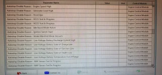

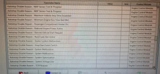

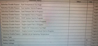

There are quite a few reasons for auto stop to be disabled.Some of them might not be applicable, but will give you general idea,why it might not engage.
Well that explains how the Axxess Start/Stop Override module works. It connects to the hood pin switch harness and creates a “Hood Ajar” condition. It also suppresses any trouble codes.
But from what you guys were saying, the "parking maneuver detected" is not working properly. 🤔
(I always back it in other than those angled spots, so no idea.)
You can get the same effect by opening the hood and starting the car. I believe bypass module has time delay normally open relay that simulates open hood during the start of the engine.
I'm pretty sure this is for automatic parking assist function Opels get in Europe. Not applicable for our cars.
