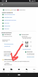

@garbageguy I'm on my third battery and have also had the battery module replaced. This month I'm still getting this error showing the battery is low. I am now regularly getting charge levels above 14 volts.
Before my other two battery replacements, I went to AutoZone and had them check the battery for free and they had verified the battery(s) were bad.
You may also want to check your email to see if you get a report emailed monthly from OnStar Services. The email is entitled "Your {December} Diagnostics Report from your Buick Regal Tour X".
I do not subscribe to OnStar. It's easy to miss on the email, but it does indicate the condition of your battery. I brought these emails (when booking my service appointments) which backed up my claim that the battery was bad. See photo.
Looks like I'm probably in line for my fourth battery. And I'm just out of warranty...wonderful.
