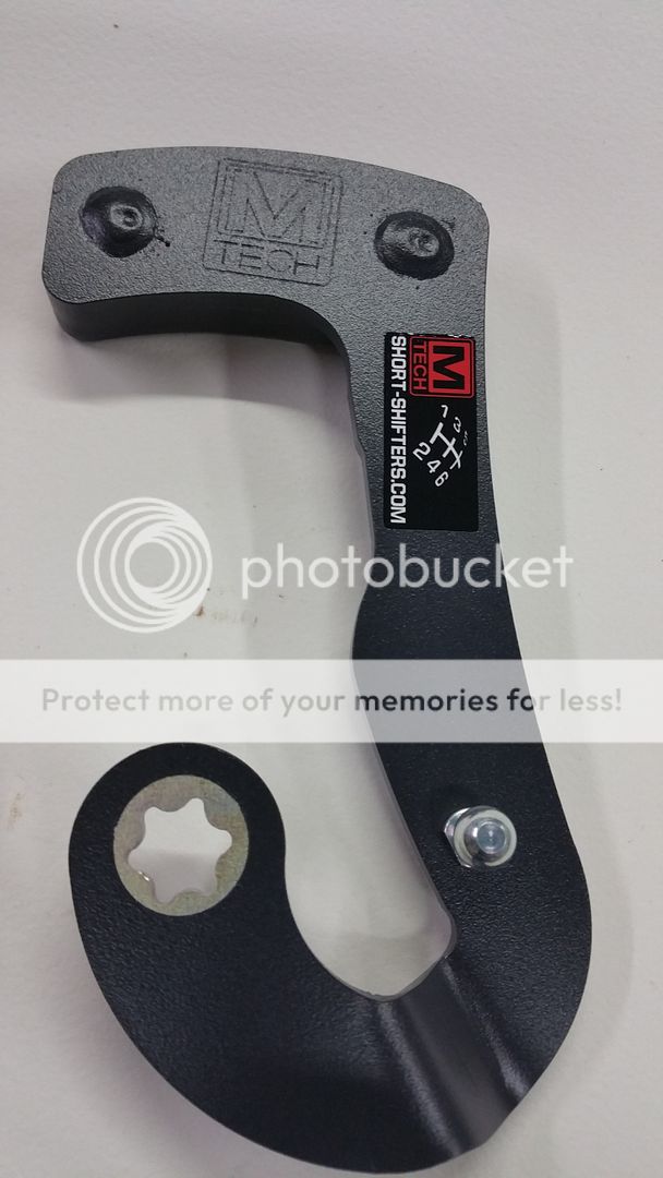

I just found and purchased the correct one for my '14 GS LTG F40.
With or without the shift shortener installed, in cold weather close to or below freezing, the gearbox on the GS definitely has clunkier feel to it.
Yessir....or until it warms up

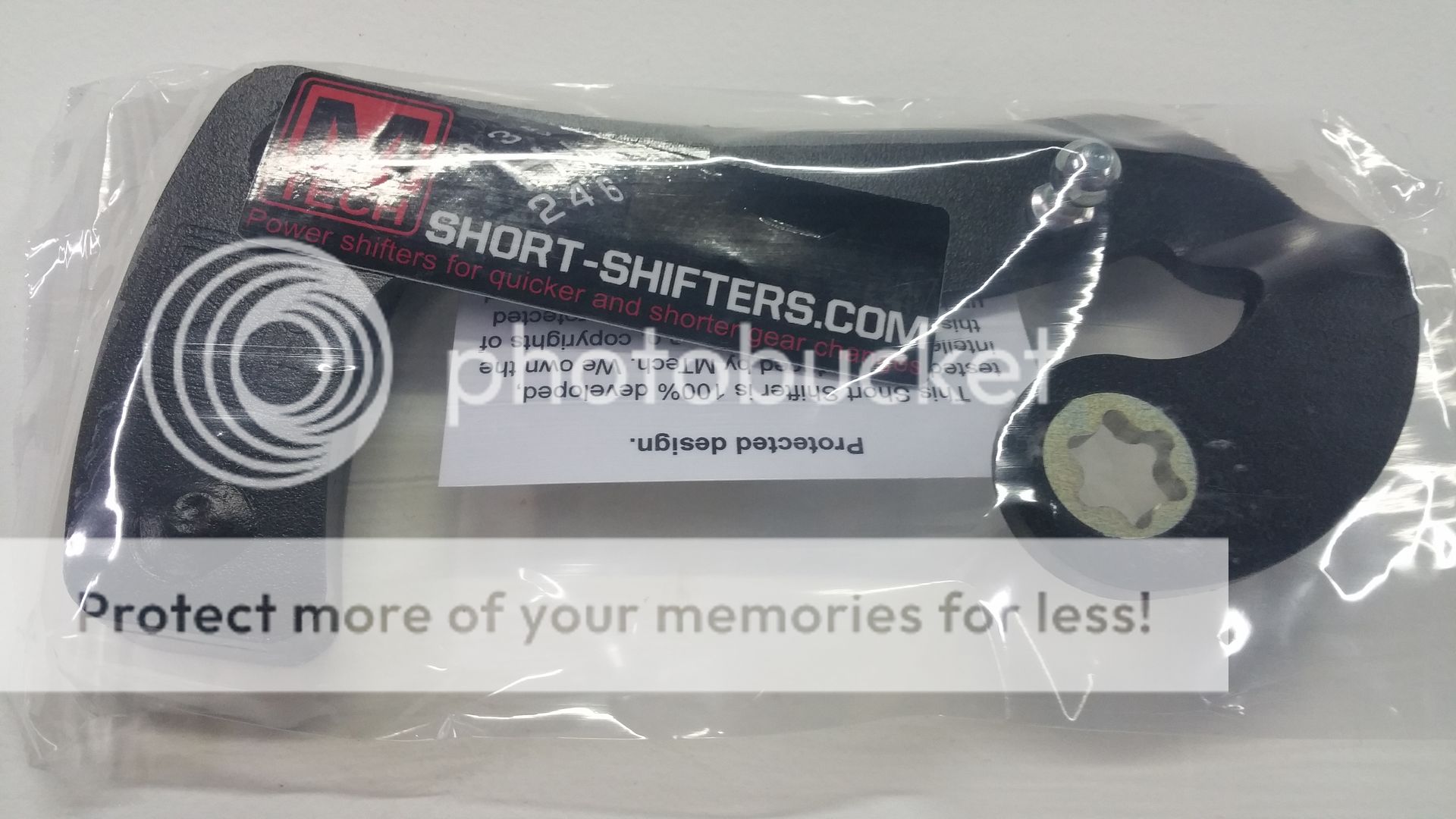

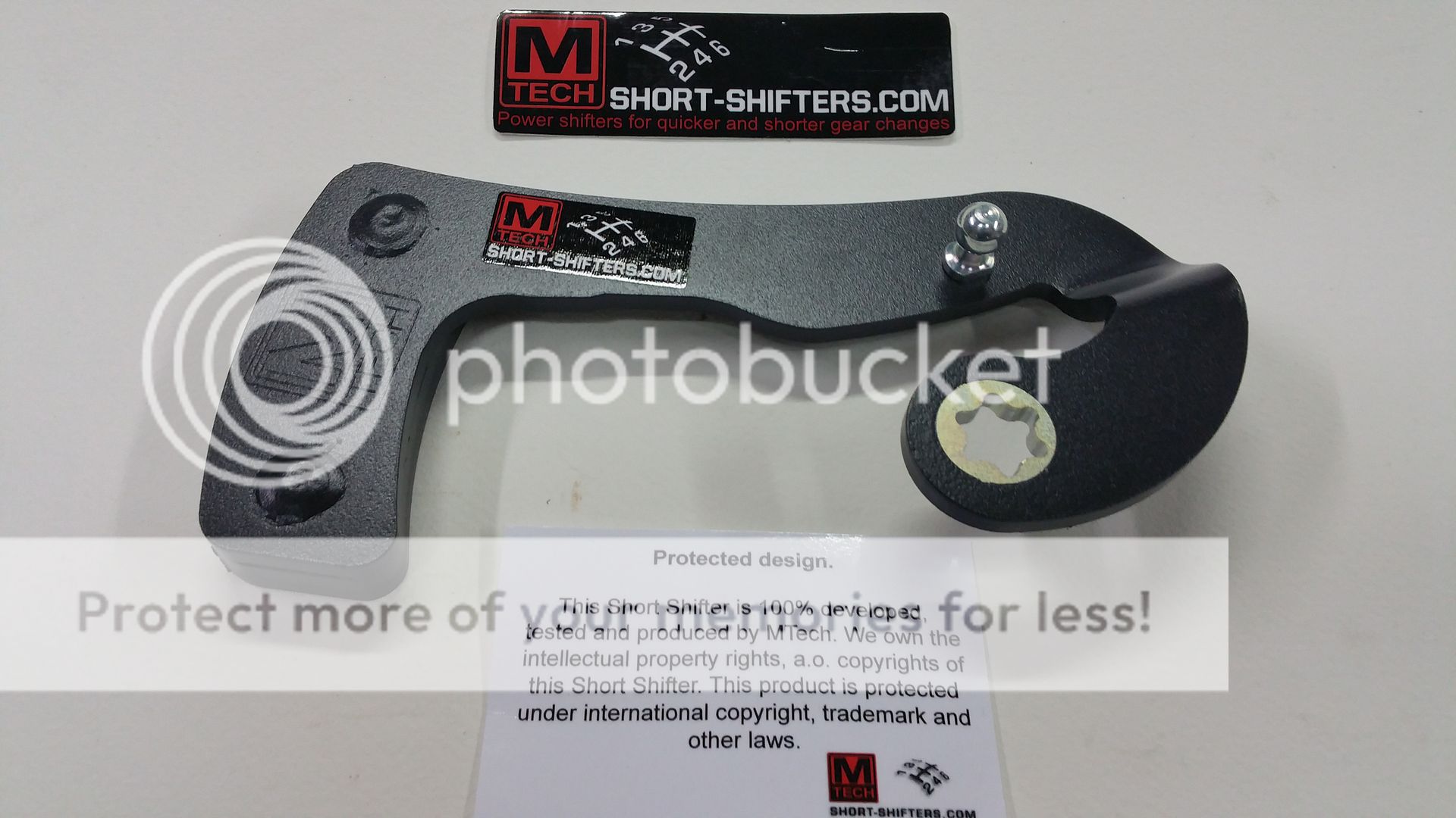

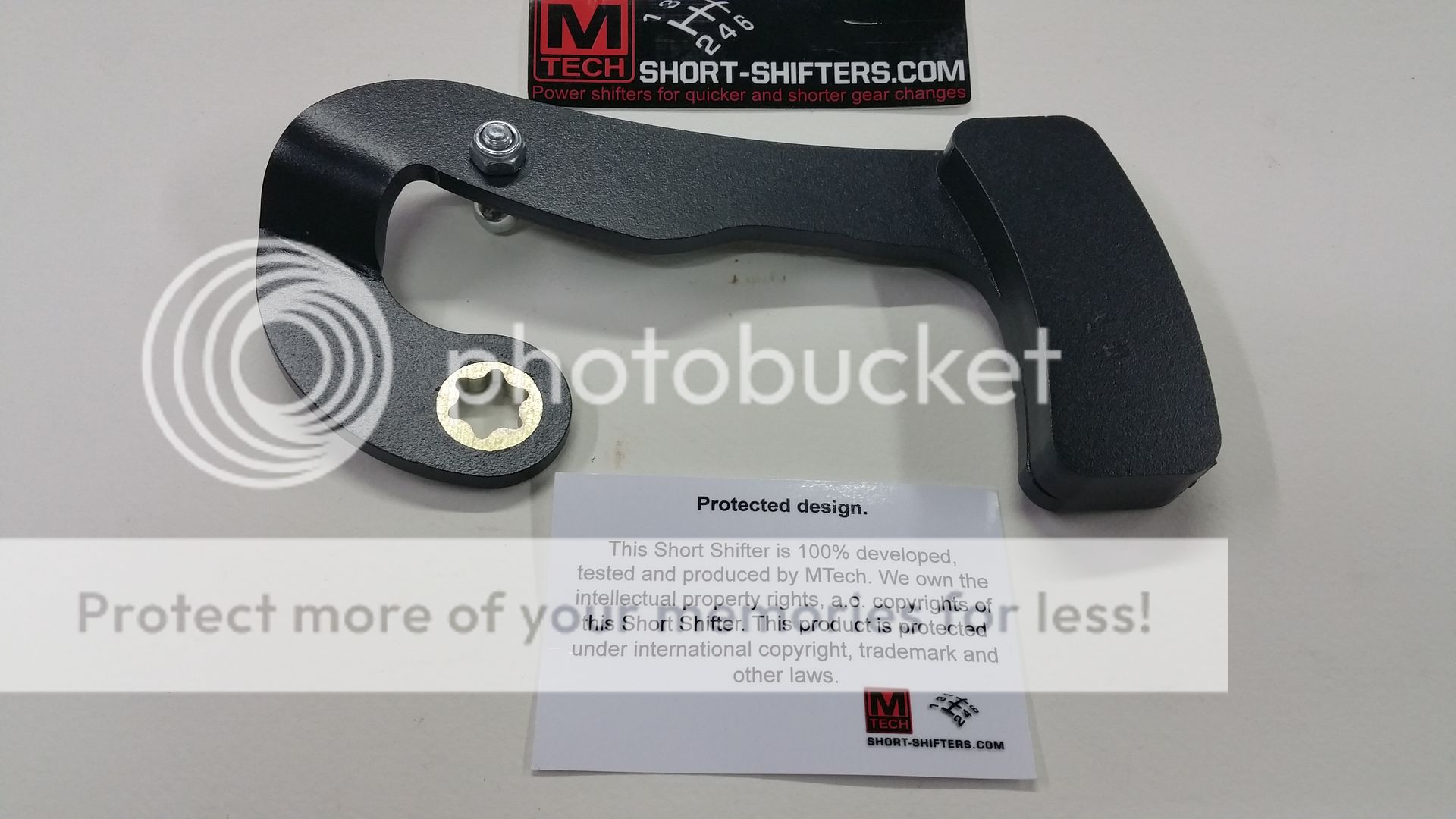

I couldn't find the correct short shifter (in North America) for my 2014 GS with the "updated" F40 transmission, so I ordered directly from MTech. I paid an extra €35,95 (doll-hairs) to get it shipped in a box rather than a bubble bag... Heavy chunks of metal in a bag get pretty beat up in transit. Plus MTech takes a notable hit by accepting foreign PayPal. Shipping took almost 2 weeks, but the shifter arrived in excellent condition with an extra garage cabinet/fridge/toolbox sticker.
