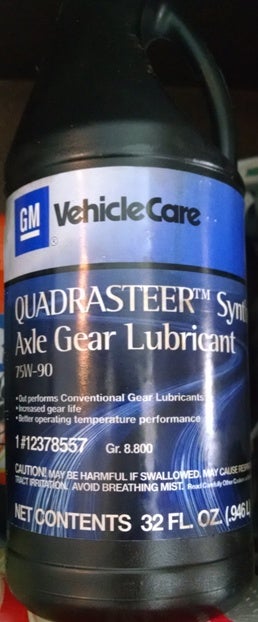

It was exactly what the local Buick Dealer brought out when I asked for
Part # 88862624.
Only the bottle didn't just say 75w/90 LS it also said "Quadrasteer" and the bottle looked super old - as pictured.
Also a hand printed label was on it.
I'll look up that other PN #12378557 & see what that shows / looks like in comparison.
