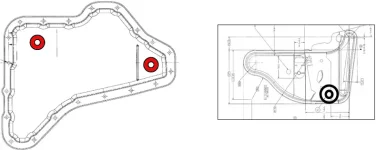

GM engineers came up with the TSB on the 2 magnets in the trans pan to help prevent the shifting problems from developing. The magnets catch the metallic clutch material that the trans filter CANNOT catch and prevents the metallic material from surrounding and attaching to the shift solenoid, which causes the shifting problem.
The metallic clutch material is so tiny that the trans filter does not catch most of it. It passes right through the trans filter and makes its way into the trans, causing problems.
As long as the 2 magents are placed in the correct place the GM engineers called out for in the TSB, there will be zero issues with messing with anything due to the magnetism.

The GM TSB reads for the 4T65e:
This bulletin is being revised to add 2010/2011 model years. Please discard Corporate Bulletin Number 08-07-30-040B (Section 07 - Transmission/Transaxle).
A new transmission oil pan magnet, P/N 29535617, was released for service. The current square transmission oil pan magnet may become saturated with normal ferrous sediment and the Pressure Control Solenoid (PCS) is now collecting ferrous sediment, making it vary from design. For a given current the PCS electromagnet is stronger, causing the line pressure to be less than needed.
So the original factory magnet cannot hold the metal particles and the particles get past the trans filter and end up attaching themselves to the PRESSURE CONTROL SOLENOID. the PCS is magnetic so it basically attracts all the metal particles in the trans fluid and the PCS gets covered in the ferrous material. This makes the PCS fail and the line pressure to drop.

One of the symptoms is the bang shift from a stop once the transmission warms up and the fluid pressure drops. Depending on make and model year GM transmission service recommendation 50-100k along with operating conditions so at some point the magnet could become over saturated and material is introduced back into the transmission creating problems.
Regular fluid and filter changes prior to the OEM magnet becoming over saturated is one method, but unfortunately most owners will be looking at that option "the day of" and it's usually to late. It's a cheap way to have addtional protection and easy enough when doing the fluid and filter changes.
Thanks lbear for the post with pictures.
