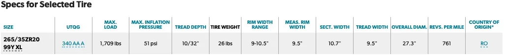

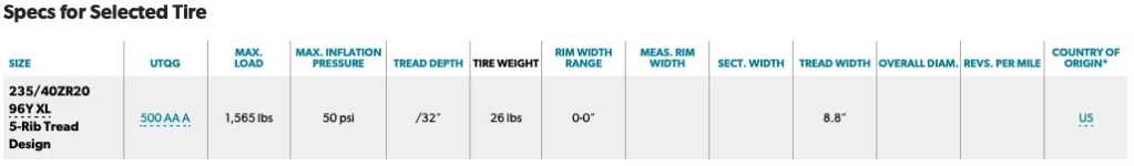

Yes, it's not the most common pattern out there. TireRack hasn't confirmed fitment on the TourX, but you can select the Sportback AWD and get a decent number of options that will fit. You can also do a search for something along the lines of 20x9 5x115 and look at the sites that come up. Just be aware and double check the actual specs. Another option is to go with something custom with the specific diameter, width, bolt pattern, offset and center bore you want. For that option, I'm currently looking at Forgestar, specifically the CF10 as I'm a big fan of clean, symmetrical design wheels. A great tool for comparing stock wheel/tire specs to aftermarket options is
willtheyfit.com which will let you see impact to strut clearance, outward projection and total diameter.
