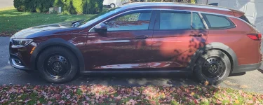

I'm looking for 17" steel rims to mount winter tires on.

I had a 17 snow set when I was up north and it was fantastic.
Were those steel rims?
If so do you have a part#, source or reference?
I had these wheels and this is the ad that has the tire spec too (already long gone)
Narrower tires but essentially the same height/sidewall on a 17. They were excellent and no problems with fitment at all.

Cooper Evolution Winter 215/60R17 <- these have been great on our '05 Pacifica for several winters, so i'm going with them on the TourX as well.

These lug nuts fit with these #83-7718 rims.
