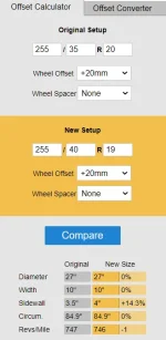

Revisiting this now that I'm getting closer to acquiring a TourX again. If Olds was able to fit 255/35/20 +20 in the front then I believe I should be able to squeeze 255/40/19 +20 without rubbing. A quick calculation shows that the two overall sizes are identical. I'm also curious if the TourX would be able to run this setup with the H&R lowering springs, considering that the Sports Tourer is somewhat lower by default.

I'm running 255/35/20 et 38 on H&R springs. I have a little bit if rubbing when the trunk is loaded and I hit a big bump.

245/50-18 on 8" wheel with 40 offset is as large a tire I would go, considering snow packing. Think you will be close
