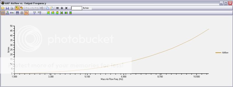

Second point many fail to realize is MAF sensors are not ABSOLUTE! In that I mean just slapping a MAL on an application does not result in Mass Air Measurement! It will give an output, but all MAF sensor in production application has a "Characteristic curve." That CURVE is output in voltage vs. MASS AIR FLOW. Changes in Ducting, flow, and Air cleaner characteristics, will change the SENSOR output vs. MASS OF AIR! )
When the air cleaner is changed, it may not be a straight linear SHIFT in the characteristic curve for the MAF output! So it may be well within a given amount of change at some Speed and load points and well outside the amount needed for a "CEL MALF" at other points!
But without a doubt changing an Air cleaner that changes flow, effects MAF sensor OUTPUT!
