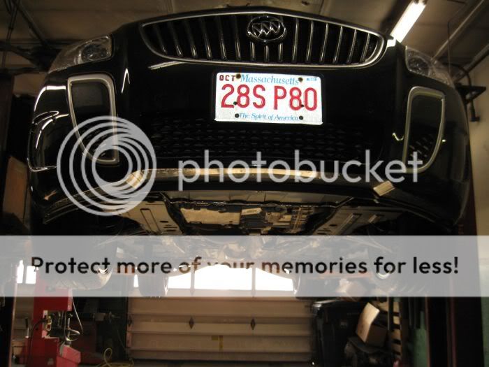

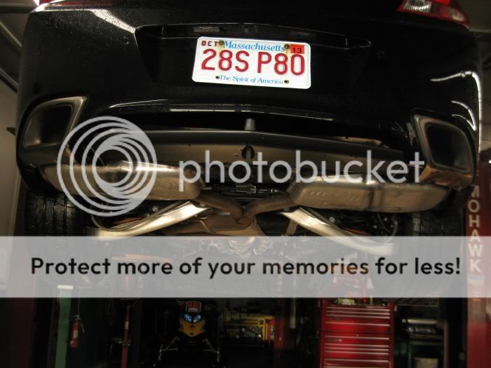

The project begins:

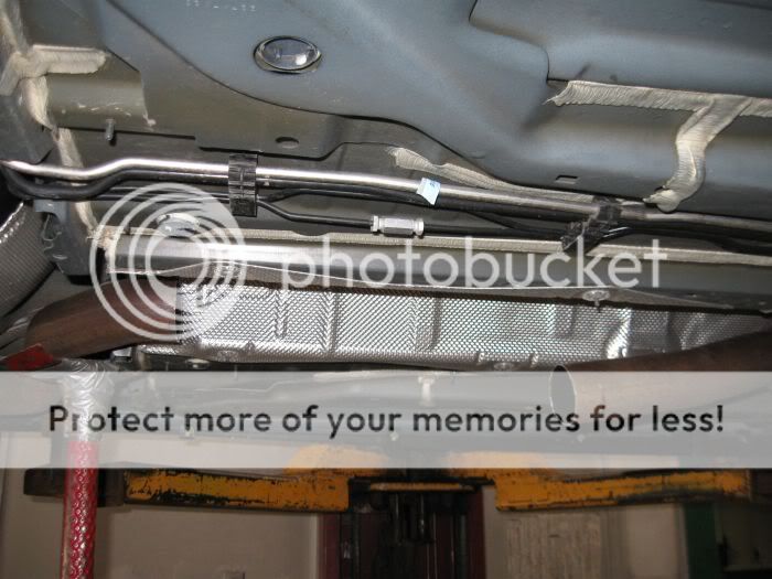

Space is limited for muffler placement:

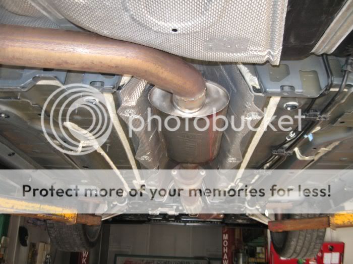

Resonator:

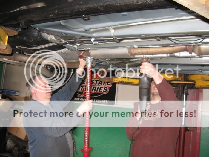

Surgery begins:
Resonator removed:

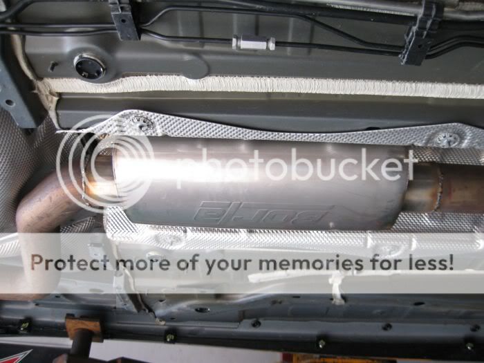

Borla muffler welded in place:

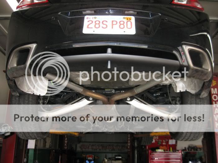

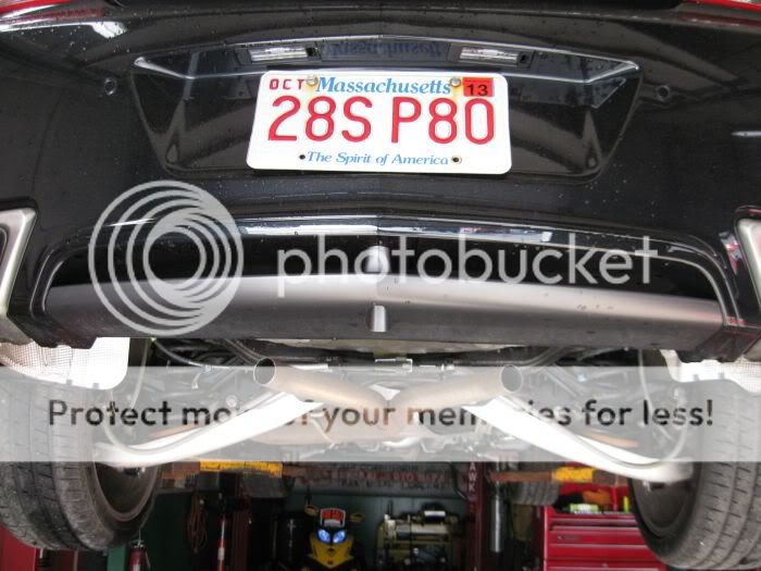

Stock mufflers removed and factory y-pipe utilized:

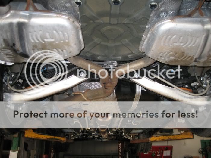

Install completed:

Post a closeup pic of the pipe near the finishing trim.
