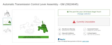

I took the car to the shop over a month ago and they told me they ordered me a new shifter unit. Still no call or any word on the part. I ended up removing the jumper harness. I get the StP message but very rarely now. Before it was a daily issue. But it happens maybe once a month and now to solve the problem I just flick the shifter button and it goes away. Very strange. Not sure if this will turn into a recall or not.Are you still not able to use the manual shifting? Have you resolved this issue?

There is a problem with electronic parts suppliers since they sell bulk and you will buy a bag of these switches.Yeah...I'd just source the Omron switch from an electronic parts supplier. No need to pay extra money for a knock off.
You can buy a single switch from Digi-key. Says it’s Omron branded part.There is a problem with electronic parts suppliers since they sell bulk and you will buy a bag of these switches.
Amazon also sells Chinese copies of Japanese-made Omron switches. "According to the original factory specifications."
