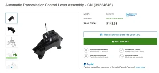

Just had dealer replace the "Shift Control" today. The "Shift to park" msg was getting to be an everyday occurrence and hard to get rid of. The original (see Picture) was part# 39171639. They replaced with an updated version 39224646.
Part $225.70, labor $450. was glad I had a 10% off coupon.
All is well now, hope someday GM does a recall and reimburses those of us that paid out of pocket.

Waaaaaay too much for labor. For anyone else having this issue, just purchase the shifter and DIY. I replaced mine myself. It took about 1.75hrs total and I even got a 7cent refund (found in the crevices after removing the panels lol). Difficulty was probably 4/10 only because it was the first time I had removed those panels before.

I also bought a new shifter part# 39224646, not a used one since this will fail soon too.
Just replaced my shifter assembly with the newer part - took about three hours, start to finish. No error messages!
Just purchased 39224646 for my 2019 Regal GS. Hope this solves my problem. I really appreciated the discussions around the switch itself (I’m highly technical - especially in electronics/controls). But I’m not sure I followed if we aligned on an actual part number. I went the expensive route. LOL

My messages aren't being approved but putting this here in case it does someday.... I've confirmed that this part fits and fixes my issue. Probably about 2hrs from teardown to reassembly. Not too difficult if you've taken apart interiors of newer vehicles. I did pull apart the old unit. I think the switch is likely fine. To me, it looks like the shifter itself gets a little "sloppy" over time. I feel like it doesn't always move forward enough to make good contact with the switch. I'm guessing a few wraps of electrical tape or shrink tubing around that switch's "arm" would probably fix it. Maybe even slightly bending it outward a bit.
