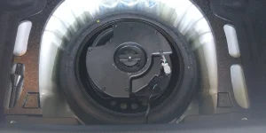

It gets better 😛...a 145/70-17 does fit with speaker, jack, etc. It's a nice tight fit - actually had to remove the rear plastic trim to get it in there (or force the tire by, bending the plastic). I have to remount that one though, it came on a non 5x115 rim.
Looks like:How tight is the fit of the tyre/wheel between the front and rear sides of the well?
What size is your tyre? Mine is a 125/70R17
If you can see under the wheel, towards the front, there's a thin foam pad that i pulled from some GM vehicle. It was a circle with a section going straight across the diameter (like the Greek letter Phi), which i split in half. It fits under the front half of that wheel in the well and balances the fit so that the wheel sits flat and doesn't wobble. The fits is so tight on the outside of the tire, though, that i don't think it would move in there anyways.
Thank you.If you can see under the wheel, towards the front, there's a thin foam pad that i pulled from some GM vehicle. It was a circle with a section going straight across the diameter (like the Greek letter Phi), which i split in half. It fits under the front half of that wheel in the well and balances the fit so that the wheel sits flat and doesn't wobble. The fits is so tight on the outside of the tire, though, that i don't think it would move in there anyways.
I think it's more important to note the differences in body style and drivetrain than brand/model (wagon AWD vs. sportback FWD/AWD). My GS shares the same limited space in the spare wheel well as @ZB Commodore Owner's RSV. I tried fitting the foam pad @visitor mentions under my spare with no luck. It's simply too tight.From the various pictures posted in this thread from different vehicles, I can see that the trunk wheel wells on the different models (Holden, Buick Sportback, Buick TourX) are indeed different. That's why there was clearance on all sides in my Sportback trunk well with the Falken FK-090 T125/70/17 inflated to 55 psi.
Thank you. That is appreciated.I think it's more important to note the differences in body style and drivetrain than brand/model (wagon AWD vs. sportback FWD/AWD). My GS shares the same limited space in the spare wheel well as @ZB Commodore Owner's RSV. I tried fitting the foam pad @visitor mentions under my spare with no luck. It's simply too tight.
When I get a chance ZB, I will take some pictures to document what I've done to make it work in our style of wheel well.
