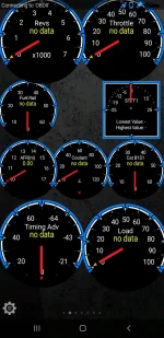

What is the Torque OBD2 app?
Handy app for OBD2 stuff. $5, plus about $8-$10 for a cheap bluetooth dongle for it to read.
Comes in handy for checking and clearing codes, plus just fun in general for logging and watching what the car is doing. Can see soooo many parameters, such as wideband O2, oil temp, transmission temp, injector pulsewidth, calculated power output, knock count, and on and on and on. Can even record a video while overlaying OBD2 data, which I wish I had a decade ago at autocross. Uses the phone's accelerometer for a G force circle, rpm, throttle position, speed, a map. Just really cool, in my opinion.
My dashboard
Can record logs at 10hz, but unfortunately the cheap dongles are slow, so I might get 10-12 PID/sec. Which means it's typically recording about 1 refreshed data line per sec. The more expensive dongles will be 10 times faster, but cost 15 times as much. Where slow refresh is annoying is, say, rpm on a 0-60 run. It will log big steps, like 3,742 rpm, then step to 5,281, then suddenly it's the middle of the next gear at 4,729, etc.
I've used longer logs averaged out to make fuel economy vs speed curves for past cars too. Will do the Buick someday. But with work just 17 miles away it's hardly fully warm by the time I get there (coolant warms up quick, but oil takes longer, trans a lot longer, diffs I am sure even longer yet).
