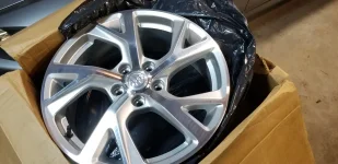

Just pulled the trigger on some Equinox take-off wheels. They'll be for my winter set.
I'm hoping the Buick caps will fit, 'cause the wheels I just bought from ebay don't come with any! Most research I can find is that the last year or two GM cars had the same size centercaps so I'm assuming they will. When I get them, I'll find out.Not bad. Same size and bolt pattern? I wonder if the buick center caps will fit?
These Equinox wheels are the same 5x115 bolt pattern, same 18" diameter as the TourX. Offset is 43 vs stock 40 (close enough)
They're narrower, though - 7" vs 8" wide. I plan to run 215/55 winter tires on it, which the tire calculators say is the same overall diameter as the stock 235/50 so it won't mess up the speedo/odo.
Will do. It'll be a while though, as I still need to order tires and TPMS sensors. I'll check the center caps quickly enough, though. Wheels come in next week.Post up some pics when they're on. I can't stand the factory wheels. It's my wife's car and she could care less, but they drive me nuts.
I would be afraid of mopar rims due to clearance on the outer fendersLooking at wheels myself for after the winter and am finding options in the 20" size, but offset is 20mm with an 8.5" wheel. has anyone ran that little offset and have photos?
thats my worry, the widest id think would be a 8.5 wheel, bringing the total out by 1.25" roughly.I would be afraid of mopar rims due to clearance on the outer fenders
Advanti "Hybris", 18x8, 5x115, 35 mm offset, same as factory. BBwheelsonline.com . Great company, fast ship, best price I found on this particular wheel.
Shouldn't mess up suspention geometry much, which is good.My research led me to 35mm and the wheels look the same in the fender wells as original. 5mm is almost unnoticeable. A 35mm offset would be tucked in 5mm more than 40.
isnt a 35mm offset going to put the wheels further out, not in? getting you closer to the fenderwell versus the suspension components? Id presume clearance is still fine, but just wanted to clarifyShouldn't mess up suspention geometry much, which is good.
.isnt a 35mm offset going to put the wheels further out, not in? getting you closer to the fenderwell versus the suspension components? Id presume clearance is still fine, but just wanted to clarify
