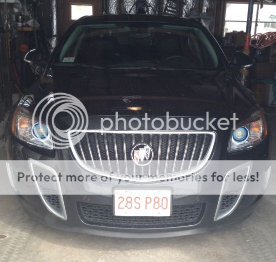

I've finally been able to set up an online photo account and post some pics. I love the look these DRLs brings. It makes the GS look so cool at night.

Finally got around to removing the LED strips from the custom install and install the actual kit from China.
Unfortunately it's still winter and the car is dirty as fawk.

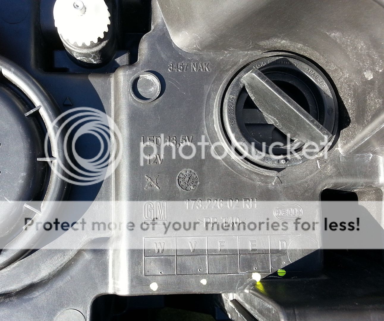

I had my headlights off the other day. The exact bulb #'s (<-that's not a hashtag) are on the back of the headlight housing/assembly next to the plug to access each bulb. On my '12 GS that bulb is 3457 NAK.

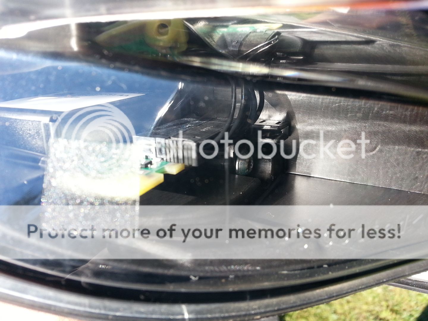

This control box, mounted to a small 3"-4" circuit board is in each headlight,(under the L.E.D's) on the bottom/outer edge, hidden by the bumper and fender.
I can't see how many or what color wires go into the back of that control box. I do know that 5 black wires come out of it..... 2 wires go to the 3457 NAK bulb and 3 wires go up to the L.E.D's.
Next step is to get a used Headlight so I can put it in the oven and open it up.😉
