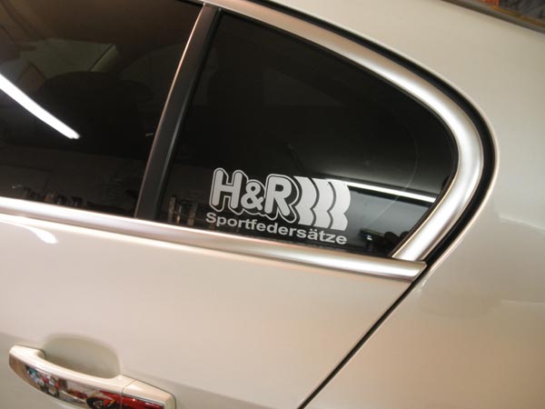

It should work fine... I doubt that a local shop will be able to get it since they go through the same Eibach USA idiots that are still looking for a test-vehicle :p Your best bet is to google a dealer in the UK or elsewhere in Europe that will ship to the US. I got mine for $275 shipped.
Oh... and I have one more pic to complete this thread ;)
