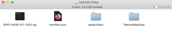

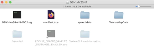

If the cards aren't working I'd try to return them. Tell them you have a car that is on the compatibility list, there's no way they would know otherwise. The sites I looked at all have all have reasonable refund policies if they really honor them.Well, that's just to format the card to FAT32, really, which is the correct "format." For all i know the newer 86810236 cards from gmnavdisc.navigation might have the same data from whoever creates the cards, but if those ones are different and NaviUpgrade is just cloning the data using a Windows OS, that might explain why Chefjpd's isn't working and we may be in the same boat.
The other problem might be that if anyone tries to return the cards to NaviUpgrade, they may ask for verification of correct application which, technically, we don't have with our Regals.
Anyways, Chefjpd is sending me the card he got and i'll compare it to mine and go from there, although i expect they'll be exact matches.
I'm still curious if the 86810236 cards from gmnavdisc.navigation are 32GB or 16GB... 🤔
