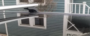

I didn't take any beauty shots, and my wife has the car today, but here's a screenshot from video I did of the sunroof opening under the front bar. There's about 1/8" clearance. 15113
The sunroof sure is reflective. Back bar is placed way behind the rail dimples, I used the back edge of the glass to align & keep it parallel. Might move it further forward, but I wanted a wide span for the 13' kayak. Front bar is just behind the front dimple.

I didn't take any beauty shots, and my wife has the car today, but here's a screenshot from video I did of the sunroof opening under the front bar. There's about 1/8" clearance. View attachment 15113
That would not be a happy day if you had hardware mounted to the racks and pushed the moon roof open button.
Maybe that is why the OEM racks are tall like a giraffe.
