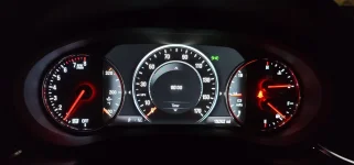

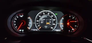

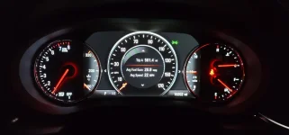

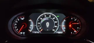

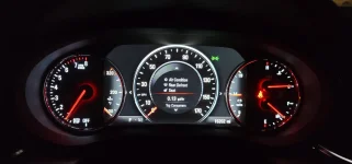

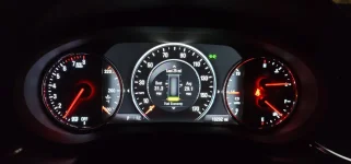

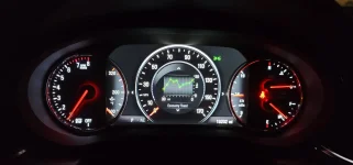

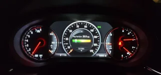

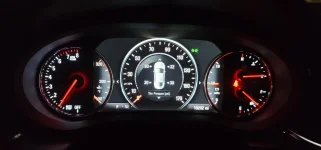

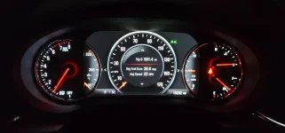

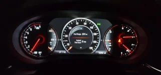

So, car info menu will display the following:
speed, average fuel economy(horizontal bar), economy trend (graph), top fuel consumers, trip timer, fuel economy for last 25,50 miles (vertical bar), tire pressure , oil life, fuel range and instant economy, trip A,B distance and average speed and fuel economy.
performance menu:
G-force meter, friction bubble (works only side to side), x to y speed performance timer, lap time, oil temp, oil pressure, battery voltage, trans fluid temp, engine boost.
Two side pockets are showing engine oil temp on the left and battery on the right.
It seems like you would need to have performance menu enabled, to display desired parameters.
P.S. Needles to say, how cool is the GPS on the middle of the speedometer.
P.P.S Thank you Chris @GTPprix for making this possible. I got close to understanding programming of it, but have no access to VCI files and have no idea what else goes on the brand new one, other than vin and environmental code . I think I can make used one to work, though )))
P.P.P.S I'll upload the pictures later today.

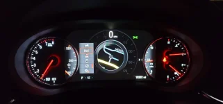

P.S. Needless to say, how cool is the GPS on the middle of the speedometer.
When you say this, are you referring to the turn by turn instructions in the cluster, or the full map like the Opel/Vauxhall/Holden variants are capable of?
Uniqez
494
239
2018 Opel Insignia Country Tourer with Buick steering wheel, HMI and floor mats
Exactly this. Full map. I'll upload picture of this too.

Pictures time - car info menu.
