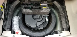

I was thinking about putting something under it, but then I just tighten the nut and test it. It feels pretty solid and doesn't rock. There is only one thing I'm planning to add - some cushion tape on the rib that spare sits on. Just to prevent from damaging the paint, if spare ever moves.Uniqez: Did you put anything underneath the spare to cushion it? It seemed to me it might rock and make some noise so I put a rolled up beach towel under it. But, maybe once the wing nut is tightened down, it may not move around - I didn't test that. There's plenty of room to store small stuff under and around the spare.
Unfortunately, I gouged the sidewall of a tire on my TourX and I got to use my spare, a P/N 9594807 out of a 2010 DTS. This wheel does rub a bit on the brake caliper when driving on my car (replaced front right.) I did not have to do more than 3 miles of driving on it, thankfully. The removable piece in the cladding (just pull toward you) at the front jack point was good so a scissor jack could fit and not damage the plastic.
Yeah, it's this black alloy wheel:
It was drivable for a few miles. If I had to do more than five miles on it, I think I'd opt for a tow.
