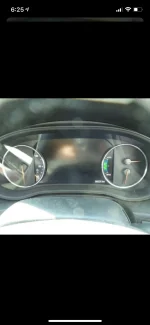

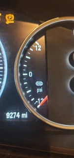

Soo regarding what’s been mentioned about red needle pocket gauges not being modifiable...I found this picture of a car being wrecked here in Australia and the cluster shows a different right pocket gauge. Obviously this is with minimal power mode with doors open but push button not started...
Is this a random error or potential hope for progress in the near future?

Thats a default hybrid gauge. It shows up even when not configured on a vehicle with low battery conditions and you still cant modify it on the user end from the wheel like the 2018.5+ .
Darn I had my hopes up somewhat there!
