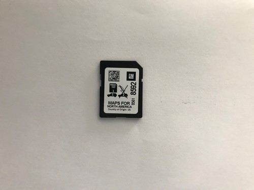

...anyways. the newest (?) # 85618592, still @ $99.99 but again on back-order, does work in our '18. :thumpsup:
Thanks for the info.
Sounds like I am gonna go this route to be on the safe side.
I got this card successfully installed, works like a charm.
GM - INFO 3 MAP UPDATE - V.2022
COVERAGE
Canada Mexico United States of America
yeah, i don't know why the part # suddenly descended with this update, but #85618592 is v.2022.5
Just got mine from gmnavdisc.com and while it works, it is already outdated! Bloody hell! :thumbsdow
How do I know? There is an interstate highway exit recently changed to the diverging diamond interchange design during construction season going into winter. That is not reflected on this map update.
