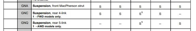

For those looking to lower their cars, at least the FWD Sportbacks with the 4 link rear suspension, not sure about the AWD Sportbacks and TourX with the 5 link rear, Chevrolet sells a lowering kit for the Malibu which is the same E2XX architecture and same basic layout as the Regals. I am wondering if their lowering kit would fit. From knowing what we know about the architecture and similarities and the RPO codes, it seems it would.
Malibu RPO Suspension Codes:
Regal RPO Suspension Codes:

I am curious as well. Will our dampers survive on this setup? Is the corner loading similar enough so that the spring rates will be effective for the Regal? Has anyone cross referenced with the Opel parts bin?

So the corner loading comment got me thinking. I did some research on the Regal and Malibu curb weights, and they are quite different.
Malibu seems to be 3,100 to 3,300 lbs.
Regal and TourX are 3,700 to 4,300 lbs.
Have you looked at the H&R springs in detail? There are 8 different versions for our cars. I suspect that it relates to weight distribution based on engines, transmissions and other options. The Opel packages are not quite the same as ours so I have an email into H&R now to dive a little deeper.
Could you ask if they have a stiffer spring than keeps TourX ride height as is?
