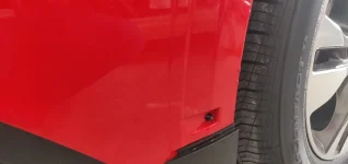

So as an update for those interested this is what it looks like under the plastic forward of the bumper seam.
13694136951369613697
I am going to fill the notches and paint first. If it doesn't turn out as well as I like, I will get some estimates to fill and paint the bumper. I actually like the black on the side skirts and bottom of bumpers on the red. I am on my way out of town for a week or so, but will update when I get back and get the notches filled and painted.

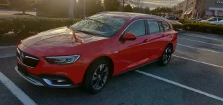

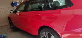

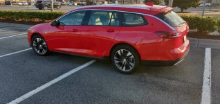

Here's a couple out of garage pics.
I am happier already. Once I get the notches filled and painted I'll be content.

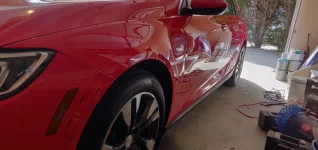

Thanks. I really am happy with it so far. I will do a short write up of what I have done in about two weeks. Won't be back in town until a week and a half from now. Pretty easy really though. Short version is the adhesive removal is the biggest headache. If you do this, the rear bumper is a place to be very careful as the paint, on mine at least is very soft. Without any heat I nicked a small pinhead size area with my thumbnail peeling a small bit of adhesive.
Longhawk
10
2018 Regal TourX
On the plastic bumpers, plastic razor blade and goo gone is what I used. Wet the adhesive and let it sit for a couple minutes, then use the plastic razor blade, took me several cycles of this. For the metal body, using a drill and 3m eraser wheel is so much easier, quicker and cleaner. I did use a plastic razor blade to trim the adhesive down close to the body, then the wheel. Would not recommend on the plastic bumpers.

That looks absolutely excellent! The little notches don't even bother me THAT much, even though they do annoy me a little bit. I do think that now the car might need to be lowered just a tad to finish off the look. That is definitely something I'm considering myself, once I need new shocks at some point in the car's life.

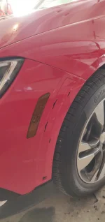

Did you finish on the fill/touch up of the holes in the bumper? Would love to see it...
