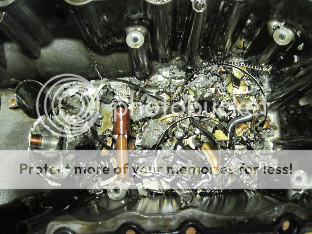

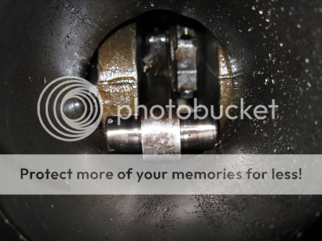

I know it is a different car, but in my Bonneville I was running an L32 (3800 series III) block with the PM rods. This is with a 3.2 pulley, oversized cam P&P blower and LIM, tune etc. basically not a stock set up. While on a road trip it dropped a valve and this is what happened.
First picture is cylinder bore with head removed, note no piston and undamaged rod
Next picture is the piston and valve in the oil pan
I believe the PM rods are stronger than the forged (broke a couple of those too), but who knows what the real limits of each are. Would be an interesting test and fun to do. Load em up and test for flex and how much force before breakage.

Wow, that's trophy-worthy destruction right there.
